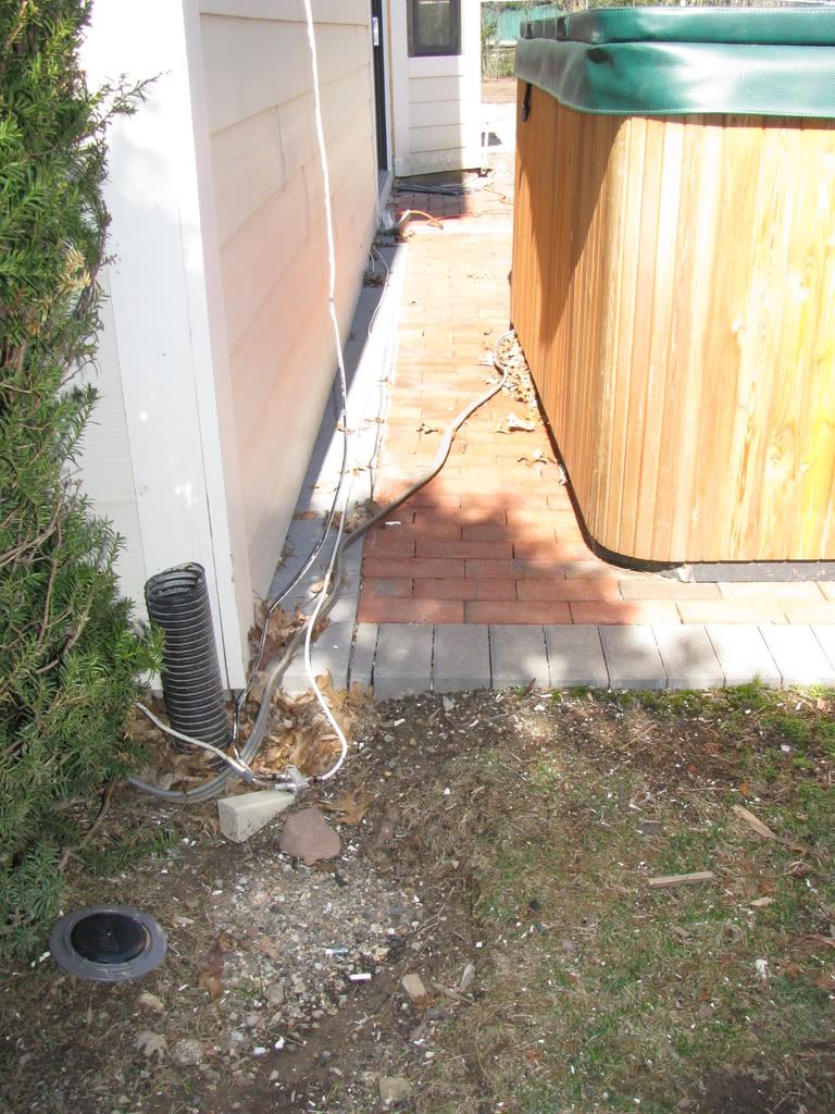

Now mind you, if you cannot tell this is wiring for a Hot Tub that has been in for a couple of years. :grin:

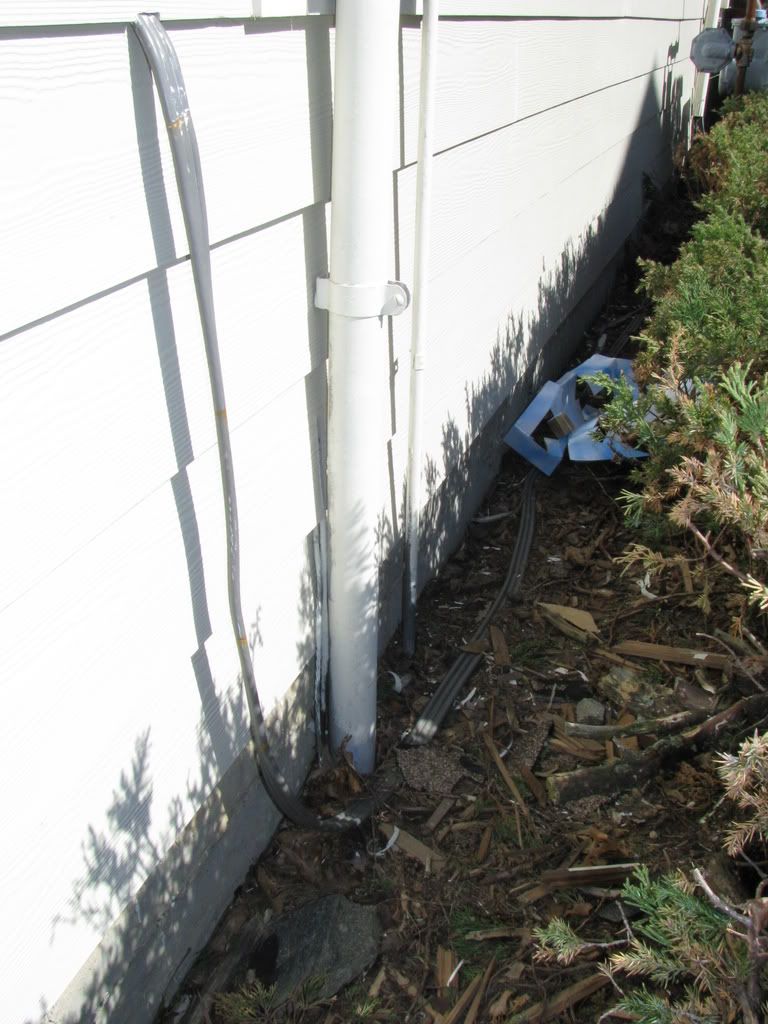

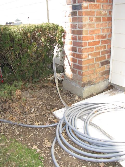

From here it is just a mess, running through the shrubs

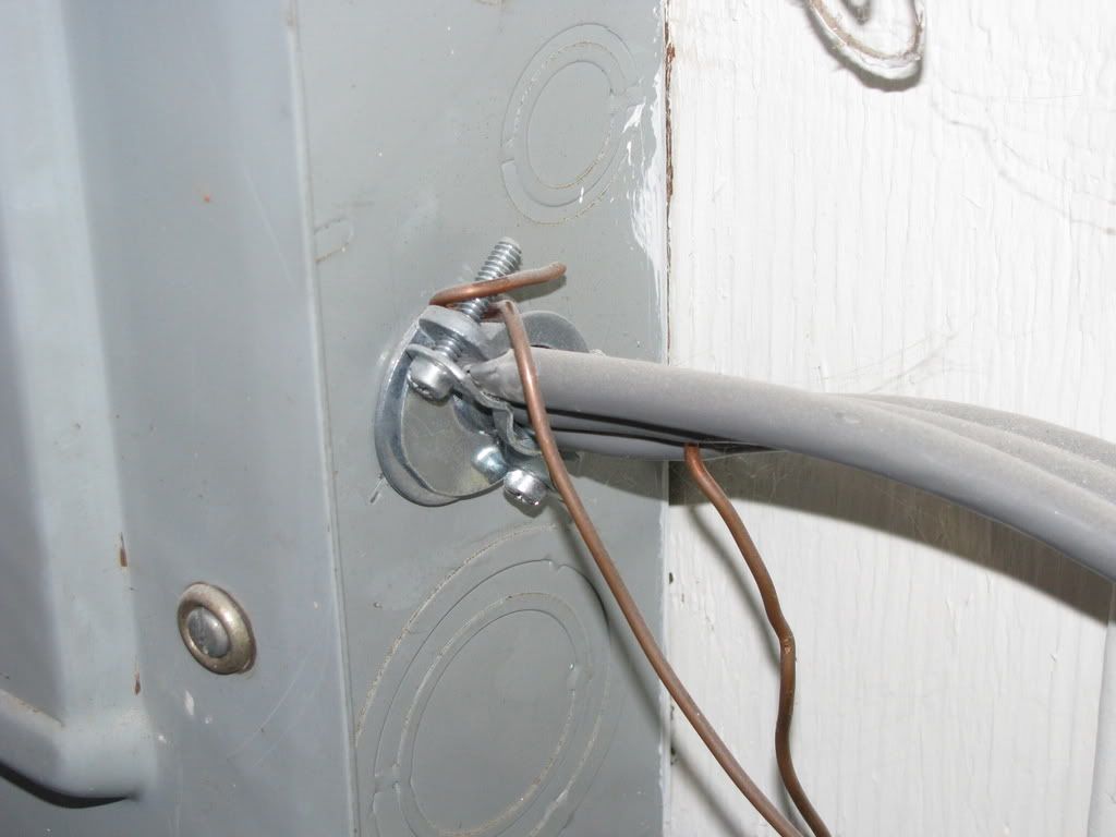

Bonding at its best
Ohhh myyyyyyyyyyy, that one went straight to the favorites. Is this the tub with the 3 guys, and a power strip floating on sandals?:roll: :grin:

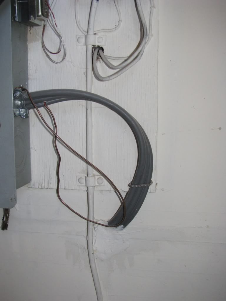

The UF going into the panel is a classic example of what is called an "Assured Grounded Program".
The Program calls for you to visually inspect (hence, 'assure') the ground wire and make sure it is touching the connector. :grin:

From the look of the work I wouldn't think it was done by a homeowner.
There was a romex connector and I did see one staple, also there was some sort of an attempt at grounding. The person probably had some knowledge of electrical. They did install a disconnect and I don't think the cable was originally on the ground. Looks as if the siding guys pulled it loose when new siding installed.
This is just a guess but my guess would be a helper/apprentice doing side work. Very little experience but some.
Most of the homeowners I see run a piece of SO cord and it's a done deal. No staples, no connectors, no disconnect and no worrying about ground. Darwin knew what he was talking about. :grin: :grin:
growler said:
.....Looks as if the siding guys pulled it loose when new siding installed......
Also looks as if the place got a new roof, there being pieces of shingles on the ground. Then again, maybe they just really need a new roof!

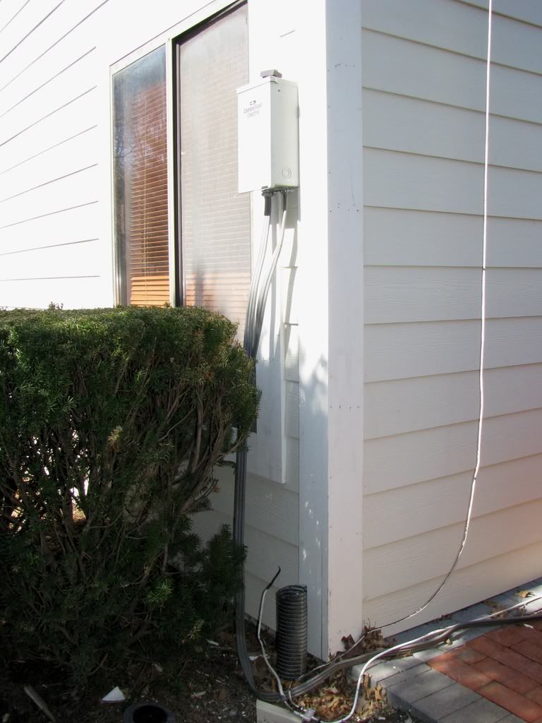

I'm assuming the "Connecticut Electric" box is a disconnect/GFCI unit?
The only saving grace to this mess, assuming a GFCI is present either in the panel or the enclosure outside, is that GFCI's don't need an EGC to operate.
Look closely at the way this is grounded. It looks to me as if there was plenty of ground to reach the ground bar originally. If he was going to just wrap it around a screw then why leave all that extra wire.
It is possible that someone removed the cable from the panel to run siding and when they replaced them they didn't consider the ground important.
I think there is new siding because the cable TV is also laying on the ground. A painter would just paint over it. Also, you can see staple marks on the cable ( rust ) where it comes out of the exterior wall.
I would like to see inside the disconnect to see if it is bonded and how he made up the ground connections. If he did his work correctly in the disconnect then he probably originally had the ground at the panel made up.
It's not good work but I do believe there has been some tampering.
