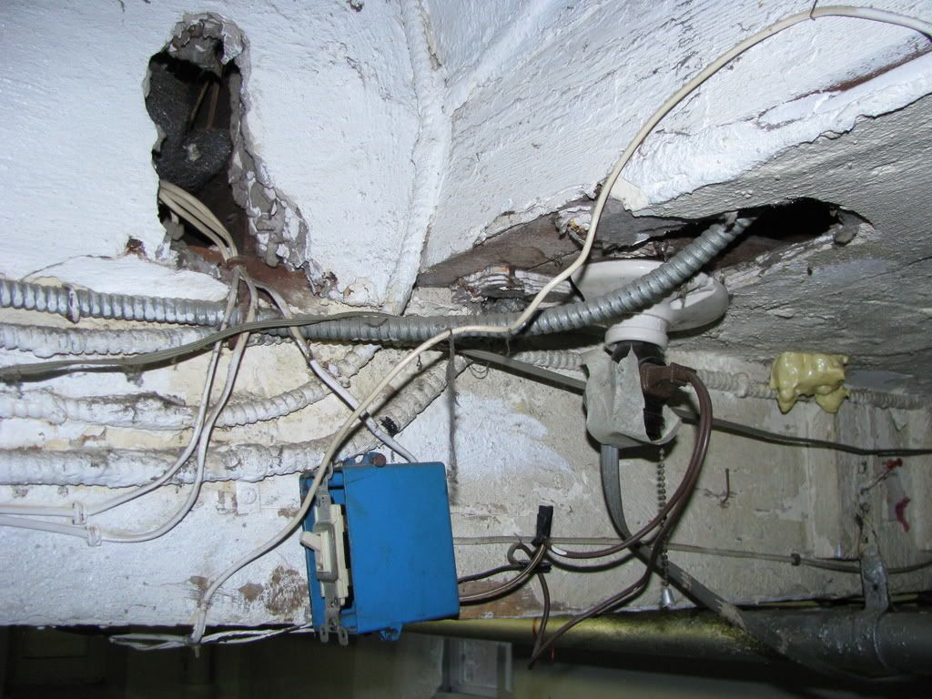

The part I liked best was the flourescent lighting. The work was first class and he used the best material money could save him...[/SIZE]
He just screwed it to the ceiling here
maybe he worked in a tennis club...notice the remote ballast install...NICE!!!
Of course these will need to be switched, there were several of these switched from this location.
Maybe it's just me but I don't see any UL stickers on those "fixtures".:grin:
You will not see a UL sticker, as these are UG rated fixtures...:grin:
The homeowner called me today to discuss this job, as there were so many violations I considered hazardous to the homeowner and family, that I notified the building department and recommended the corrections to be performed.
The homeowner in turn told me that the agreement to buy the house with the prior owner was for the owner to have certain electrical items corrected.
Well it seems that the person who performed the changes (which included a service upgrade- full of violations) is not a licensed electrician.
Now we are in the process of bringing him up on charges of working without a permit, working without a license and the utility company is going to see to it that he has an issue with tampering with their equipment.
Pierre C Belarge said:
I know times are tough and we want to save the customer a buck, this may have stretched that philosophy a bit much...
Couple items that I thought interesting/ironic:
1) Someone (and can't blame this on the "electrician") plugged what looks like a washing machine or other heavy appliance cord into the light socket receptacle.
2) Someone was presumably concerned that the unused light socket might be a hazard, so they thoughtfully put some tape to cover it.
:roll:
You could have a field day with "spot the violation" with this one picture.... Note the brown lamp cord, for instance.

I must give the man credit where credit is due. He saved himself a whole $14.99 by making his own lights rather than going to the big box and buying a shop light.
And he did use a Carlon Zip Box to enclose that switch. He could have just as easily screwed it to the beam.
