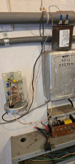

I have a water tank/booster station at the top of a mountain where the water is supplied by a pump station at the bottom of the mountain. There is a mechanical pressure switch at the top to call for water. For control at the bottom to turn the pumps on, there is a Wheelock CRT-T-40 telephone relay operating at 90V, 20Hz. The wiring between the stations is a telephone line. Is there a modern way to accomplish transmitting a signal here? The stations are about a mile apart through woods. The telephone line route is probably longer.

Radios and cell phones are subject to jamming, interference, and network failure. The only thing a pair of wires has to worry about are a tree limb falling or someone with a pair of snips.
Are you sure the Wheelock relay responds to the phone line ringing? How does the pressure switch, with only a pair of contacts call that line? My guess is there is a dialer like an elevator phone with its button rigged to work off the pressure control contacts.
There is actually a simpler way. Phone company can supply a dry pair from the pumping station to the water tank. Then you only need a relay at the top and the pressure switch contacts with a small power supply on the other end at the bottom.
"telephone line" could just be a long dry pair and that the sender applies the ring voltage which activates the wheelock relay at the pump. Using a sensitive relay like that makes sense for the distance and simplicity.
I once had a large garden apartment complex that had multiple boiler rooms. The super wanted to monitor the boilers for shutdowns. Not sure how it came about, but when I got there, they already had dedicated dry pair phone lines from each boiler room to the super's work room. I kinda think nobody could make it work. So, I made up an annunciator alarm panel with "sensitive" relays and a DC power supply for each building which is probably still there today.
The thing to remember about dry pairs from the TELCO is that they may not directly run from point A to point B. They could run blocks or miles out of the way to a cross box where they are connected to the pair going to the destination. Or they could even wind up at the Central Office where they are connected.

Is there power going to the top? If so, you could use a line carrier modem, also known as a “power line carrier” (but that gets confusing in our industry because PLC means something else). It superimposes a communications signal onto the power wires that are going there anyway. The hardware at either end is more expensive, but no need for another wire nor is it subject to the issues with radio transmission.

I worked on a lot of that kind of stuff :D. One company had probably 250+ dry pair "burglar alarm" (BA) lines, guaranteed to pass 30 baud switched DC but were fine with Bell 103 modem signals; max length was usually under 15k ft. Also some "foreign data" (FD) lines, which were provisioned for audio-freq data and might be four-wire outside the customer prem. (We had the unpublished local test desk number on speed dial.)
Another client had a few sets of broadcast loops (mostly flat from maybe 40 to 15k Hz but beware of phase shift) plus some BA lines for monitoring and talkback.

If the telephone line based system is still working, why replace with something "modern"? As long as the line is intact, the AC relay system will outlast a radio system by a fair while.
