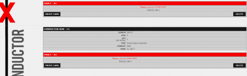

Another approach is if you could run the 480V feeder with 12,000AFC on the source end 200', you will get <5kAFC on the load end.

Remember your conductors do reduce available fault current The 30 kW load would only need 6 or 8 AWG conductors. If you had 12kA at the panel and ran 80 feet of 6 AWG to the 30 kW load, you would have right around 5kA available on the load end of the run. If you run 8 AWG it gets it closer to 3.7 kA
