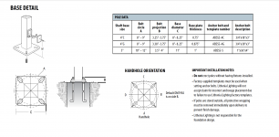

Does anyone have experience installing / repairing streetlight hit by a truck?
I've done it before but the poles were 12' hinged and never had the foundation bolts disturbed too bad
What I'm Looking at
  1. harness to gradall lifting 25' streetlights from existing base
  2. protect bypass wiring couple weeks until work complete
  3. engineer stress test existing bolts for adequacy,
  4. inspections / permits for a repair? I used to work for the government and my boss was the AHJ
  5. concrete contractor to demolish concrete foundation as necc
  6. precast [3000#] or new pour foundation
  7. harness lift new pole onto new plate
Its on a sonatube foundation. The truck mustve been pretty tall.
The pole is canted about maybe 5-10^
base is at 2'-6"; pole 25'-6"; mounting ht is at 28'
Pole is 245LBS and each arm on the top weighs 75LBS for a total of 545LBS
The bolts are 17" long with a 3" hook into the concrete.
Of course they want me to just straighten it.
Well put on your big boy pants for sure.
I want to contract most of this out and tomorrow I will be making the calls.

Is this California? Looks like they used straight anchor bolts, as I have never seen a L anchor bolt pull out of the base. If the base is not cracked anywhere, I’ve seen new anchor bolts down drilled and epoxied in. Definitely would not reuse pole, too much liability even if the flags is straightened.

That must have been a pretty good hit. Those bolts looked stretched out in the concrete.
They definitely need to be replaced

I went through a plan review with a reviewer that came from Cali, he would not approve L bolts, and wanted straights. He said L bolts would pull out, where straights wouldn’t. I call bs on it, my pole guy, who had been doing it for 30+ years said he never heard of it before either. He had to special order the bolts because nobody carried them. They do some strange things out in California!

That engineer is backwards..
common sense says so.

Most pole manufacturer's have a typical base design for their poles. What type of anchor bolts do they show in that typical design?

This is pretty typical with most we pour.
I have got poles with manufacturers drawings showing straight bolts, but they all have nuts on the bottoms of the bolts in concrete to prevent pullout.
For street light foundation bolt damage, I have seen the concrete chipped back, bolts cut off, and studs welded on, by a certified welder.

yes they are L bolts,
