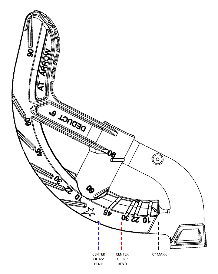

is there a formula that you are suppose to use when you have to make a 90 degree and have to add a kick to the pipe,are you suppose to add length to the pipe to make up for the kick you put in??
For a 30? kick, you add a quarter inch per inch to cover the kick.
So you have a 90? finishing at 60" and need a 8" kick at the end, you bend the 90? at 62", back up 16" and make a 30? kick.
george the conduit bender teacher. just remember that you can use the cosecant of what ever angle to multiply for the height of what you want to bend at and it will tell you how far back to bend the pipe for the kick.

Are you asking how to bend this, or how to meaure and cut the conduit first so the dimensions are good after it is bent?ok,let's say I want a 25''x60'' bend and I need a 3'' kick,to go over a beam and into a J-box?
George, when you say to make an 8 inch kick on 30 degrees, come back sixteen inches and bend,
to what mark on the bender do we need to match the mark at 16 inches?
