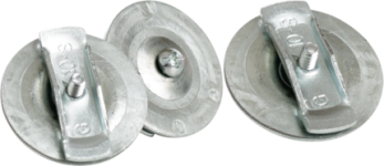

I want to plug a 1/2 knockout on a box that is mounted on a wooden beam. A chandelier is currently hanging from the box, so aI really don’t want to pull down a chandelier just to plug a knockout. Any ideas? Is a screw and fender washer good enough realistically?

Just widdle it out a bit with a paddle bit. She'll pop right in... (y)

I agree. Boxes are often mounted by removing a KO and using a fender washer to close the KO.
I think the screw and fender washer is sufficient.

My solution did not require him to remove anything. Just get a fender washer big enough to cover the hole and a wood screw.

So you had access to the missing KO. Your initial idea of a screw and fender washer is fine.
I am not clear on what the issue is. I don't see anything wrong with a fender washer, but these two piece fillers might be a little more user friendly:
The box is mounted directly to a wood framing member so the KO cannot use any type of seal that needs to go through the KO. You could take the 3 piece KO seal in your photo and throw away the bracket and the screw and just use a wood screw.

Ok. Then any of the suggestions might work. Closure requirement per code (NEC 110.12(A)) is only that what ever is used is equivalent to the box wall properties. I would even think another KO removed from a different box and drill a small hole big enough for a screw and screw it in.
