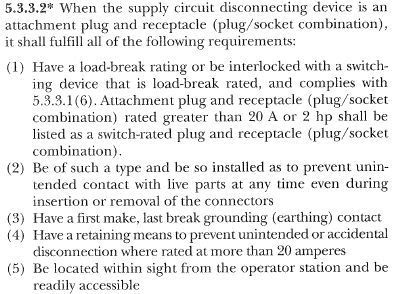

When is it allowed to use something like SO cable on a piece of equipment.
Looking at hooking up injection molding machines with a large cord and possiblt a Meltric type Plug/Disconnect unit.
Also second question;
How close does a main disconnect have to be to a machine ?
Is it line of site from the operator control ?
A circuit breaker is an acceptable diconnect ?
also curious about overhead buss type systems ?
we have about 50 machines and 100 pieces of auxillary to hookup, if we do move.
We might be moving our plant and I want to fix all the problems that aren't right with out current setup.
I ask about the Cords becasuse I'm constantly moving machines around (my boss is a lady) she tells me its like women and their furniture. She's actually great to work for.
Mike
