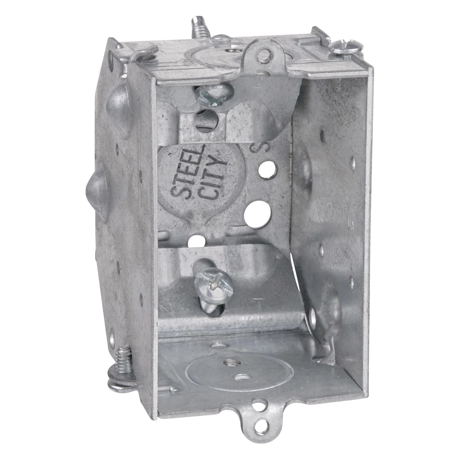

Letters T and N stamped on integrated NM clamps
What do the letters "T" and "N" represent on the NM clamps?

This may help from the UL General Directory.
METALLIC OUTLET BOXES (QCIT)
CLAMPS
Boxes may or may not be provided with clamps. When clamps are provided, the carton is marked to indicate the type of wiring system or combination of systems for which they have been tested.
The clamps are marked with the following letters or combinations thereof to indicate that they are suitable for use with armored cable (??A??): flexible metal conduit ? ??F,?? nonmetallic-sheathed cable ? ??N,?? or flexible tubing (loom) ? ??T.?? Clamps suitable for Type MC metal-clad cable are marked ??MCI?? for metal-clad interlocking armored cable, ??MCI-A?? for metal-clad interlocking armor ground cable, ??MCS?? for metal-clad continuous smooth-sheath cable, and ??MCC?? for metal-clad continuous corrugated-sheath cable. If suitable for all seven types, the clamp is marked ??ALL.?? Clamps suitable for nonmetallic-sheathed cable are also suitable for multiconductor underground feeder and branch circuit cable where used in dry locations.
Clamps have been tested for securing only one cable per clamp, except multiple section clamps are considered suitable for securing one cable under each section of the clamp, each cable entering a separate knockout
