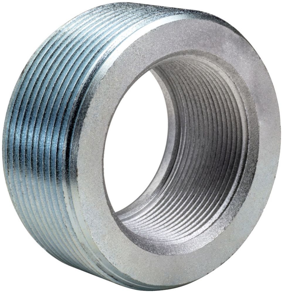

We have a motor with a threaded conduit hole on the peckerhead. The shop guys tell me the conduit hub won't fully thread onto it (making the gasketed seal). That there's still about 1/4" of thread left before the gasket would make the seal to the peckerhead.
And putting the 45-degree LFMC fitting directly onto the peckhead is not permitted, and we shall use a hub, correct?
They want to grind the threads out of the conduit opening so the hub makes the gasketed seal.
What is the proper way to install this?
Also, are there any other APPROVED methods for securing the LFMC? The only one I've found that lists LFMC specifically is an Arlington
3" conduit opening to 1-1/4" LFMC (75HP motor)
This needs to meet Canadian code as well

Myers hub i think is what most folks call them. then reduce down to 1-1/4" LFMC.
but might have to only go down to 1-1/2" LFMC, just bc the clamps i listed dont have a 1-1/4" option...
reducer
I would use a 3" to 1¼" reducer and thread the LFMC connector into that. A Myers hub is not necessary.

What code section does it violate? In fact since a LFMC connector has straight threads it can only be used with a locknut and cannot thread into anything so a Myers hub or a threaded reducer won't change anything. We would always use a threaded reducer with the connector because there is no other sensible option.
Also after looking at the graphics if this a listed package unit an electrical
Inspector out in the field can't say anything about how a listed unit is constructed.
If the thread won't bottom, screw on a locknut with the teeth facing the housing, then lock it down with the connector snugged up.
