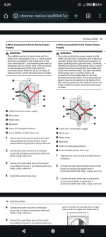

No. The manual, on page 10, specifically allows the appliance to be used on an older 3-wire bonded neutral circuit. The OP must have missed that.View attachment 2577369
Not according to this specific model owner manual, they specifically clearly required a 4 wire 240V at 50a. No other available option. I was surprise and my first to see that mentioned in the manual! There is a link for this specific model and you can check it out.
