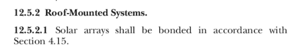

As PV design professionals, I think it's widely understood that PV and lightning protection systems should be kept separate. They are governed by different codes/requirements, and are designed to handle wildly different environmental situations.
A lightning protection "guy" on a current project is INSISTING he needs to bond his rooftop conductors to my EGC/racking whenever he gets within 6' and is threatening to withhold the UL Master Certification Label if he's not allowed to.
I've searched what I could in NFPA780 (UL96A and LPI175 I would have to pay for) and can't find any reference to this. Any citations from the gourp would be appreciated. I've already pointed out the earthing requirements for lightning protection (NFPA780 4.13.1) is very different that PV.
Why would we take an engineered lighting protection system that uses massive conductors to direct 30,000A to ground, and bond it to a #6 copper?

NFPA 780 has a whole section on solar arrays.

Therein lies the nuance. From my reading, there are two ways to ground a lightning protection system; with individual ground rods or tied into a ground ring for the entire facility. This particular facility does not have a ground ring, so by bonding the PV system to the lightning system, you are now bonding the PV array at two seperate points (the lightning systems ground rods, and the building steel) which is a no-no.
The purpose of lightning aerials and a lightning protection system is to divert the surge to ground so it does not follow a path through the building. By bonding to the PV array, you are encourgaing exactly that.
I wish it were that simple. He put his stuff within 6' of my stuff.
How would it be safer to encourage a lightning surge to dissipate [proportionally] through the #6 GEC rather than the engineered lighting protection system?
