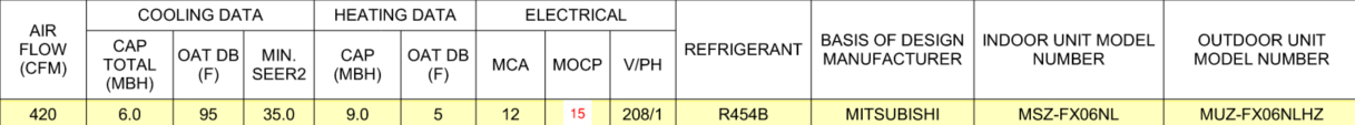

HVAC engineer spec'd an indoor/outdoor combo unit shown at the link above. Operating voltage will be on 208V, 1PH.
I have gone down a rabbit hole on how to accurately size the load in VA. I know to use a 15A breaker for MOCP and will have a 30A non fused disconnect at the unit. Below are the details I was provided.
