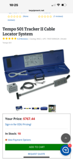

Hillybily1 has a good start. Next step is adding an actual fault locator. The one I had was $400 40 years ago. The make better now and they are good investment if you are interested in expanding your service. Otherwise, find a local contractor that’s already set up for it.
One trick- do not connect the locator between both wires, short them and put the locator from there to a decent ground. I've used a old-style toner and pick-up to find lines, although not out to 800'. Worth a try if you have the devices, and anyone doing LV should.

Dynatel 573A.
I use it for UG faults in electric lines also.
Power lines for wells in particular.
Much easier than digging and hoping, checking voltage.

When the utility (or their contracted locating company) comes out to mark lines when people use the one call locating service that is the kind of locator they typically will use. With the type of cable you have they hook their transmitter to the cable shield and that is what they are locating.
If using such a locator and there has been a break in the cable there likely is going to be signal loss beyond the break. You may not know precise location of break but will know fairly close to where it may be. If you have a locator that also has fault detection probe, you generally can be very precise with detecting the location of the break. They can be a little tricky and experience does help when it comes to learning all the quirks of using one of these. There may be some more modern ones than I am used to using that maybe aren't as tricky, IDK. I have had a hard time locating faults in unusually dry soil before. I learned (the hard way) long time ago that if soil is really dry and I am having difficulty in determining where the problem is that watering the soil for a couple hours in the suspected area will almost always turn into being able to find precise location rather quickly afterwards. The return probe on the unit I have detects the leakage from the cable you are tracing, dry soil doesn't conduct as well and makes it harder to detect that precise location.
Have you looked at the price for that? Depending on the options $8 to $10K. Still, Dynatel was always the gold standard for utility companies.

Not the 573A- you're looking at the wrong model.
It's old. I bought two off eBay for $200 each, and both work.
