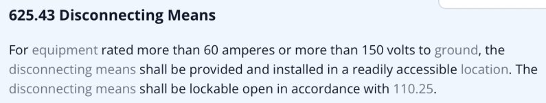

I would like to ask in which cases Loto clip can substitute a disconnect next to utilization equipment.

If you are building the project, the clip can NEVER substitute for a lockable disconnect that is compliant with 110.25.
The clip can only be used when you are working on equipment that does not have a code compliant lockable disconnect.
Note, I am talking about clips that do not remain attached to a breaker. There are breaker lock kits that attach to the breaker and comply with 110.25.
The technical term for those is a 'breaker padlocking device'. And you can use them to make a breaker a lockable disconnect per the NEC anywhere that the device is listed for use with the breaker. I used them many times to comply with article 705 in one jurisdiction that was really picky about that. 5 bucks for a breaker padlocking device sure beat 50+ bucks for a separate bladed disco on a 15A microinverter circuit.
