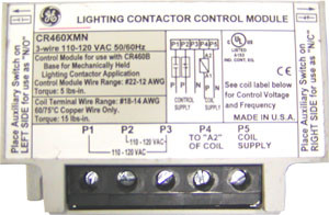

I have a bunch of the RR7s but the system has the 2 wire 3000s

Can you describe how the two wire 3000 system works? Since it is two wire it is likely a stepping type of relay, or it could be a polarity sensitive system.
In a stepping system a first signal to the relay would step the relay from OFF to ON, and next pulse from nON to OFF.
In a polarity system a PLUS signal would switch it ON, and a NEGATIVE signal from ON to OFF.
I believe the 3000s use a dry contact for control. No voltage applied.
You would need to rewire the system to insert the RR7s.

I have now found a description of the 3000 system.
This 3000 is basically a two state stepping relay. A first low voltage pulse to the relay coil steps the relay to one state, then the next pulse to the same coil switches the relay to the other state. This is a terrible type of system.
If you add an additional relay to the GE RR relay you can make the pulse stepping use a GE relay. I wouldn't want to do this. Find the correct replacement 3000 relay.
This might work to convert the RR to work like a 3000. If I remember correctly, it’s a pulse output, since the RR cannot have a maintained voltage.

For a single coil bistable relay you essentially need something that is basically a divide by 2 bistabe device. In other words you need a flip-flop.
