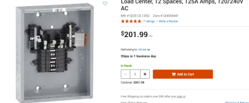

Something like this
Can the sum total amperage of the breakers exceed the amperage of the service?
Using this panel for example, could you install six 25 amp 3 phase breakers for a total of 150 amps? And if so, what are the limitations and can the sum of the amperage exceed the rating of the service conductors also?
Can’t use that panel as service equipment anymore. Has to be separate enclosures, or barriers.
OK, so suppose I'm using the right 12 space main lug panel with the main lugs covered?
I wasn't planning on using that particular panel anyway, It was just the first one that was close to the description, not to mention the rating is too low

Starting with the 2020 code you can no longer have more than one service disconnect in a common enclosure. Each service disconnect must be in its own compartment, and UL 67 has defined a compartment as an enclosure that complies with UL 50, the standard for junction boxes.

Concept is still ok with 2017. The particular panel you pictured however never would have been allowed per it's listing. All QO load centers that I know of are only suitable for use as service equipment if they have a main breaker installed.
I have used the six main rule in the past with certain I line panels. Not all of those are listed to do this with either though.
I don't know if they have changed any of those listings since the 2020 rule came along though. Haven't encountered a situation where it was a consideration.
2020 and later you can still use the panel you pictured as the main panel of a building with just the six disconnects if the supply is from a feeder and not service conductors though.
