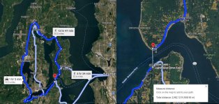

My understanding of your situation was that you have a project which has a line item "shall have a CRI of 95 or greater".
If you're just required to come up with something that meets specifications, it's not your responsibility to satisfy the flaws in the specifications that someone else wrote, or the legal requirements.
If something says locate two related facilities. "Two facilities shall be no more than 3/4 miles apart" and doesn't specify otherwise and there's no convention in how such is dealt, the below meets the requirements even if it realistically is 40 miles apart, but that is the specifier's fault.
