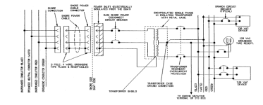

If you want to dive into the weeds of boat wiring many older vessels have what we call a 'isolation transformer', to isolate shore power from boat power (good) including the equipment ground (bad for us good for the old boat)
Here is a diagram form one such system the show attaching the shore power equipment ground to primary side transformer shield.
So the secondary side (the boat side) only has a path back to the shore via the water.
However a fault (or leakage) between the secondary windings and the shield wire (shore power equipment ground) makes the water the fault current return path.
From what I read this once common practice is no longer approved due to the fault current ground loops. There are galvanic isolators that people install between the shore power equipment ground and the boat frame 'ground' that accomplish corrosion prevention and keep the fault clearing path.
This article by David Rifkin goes into more detail:
