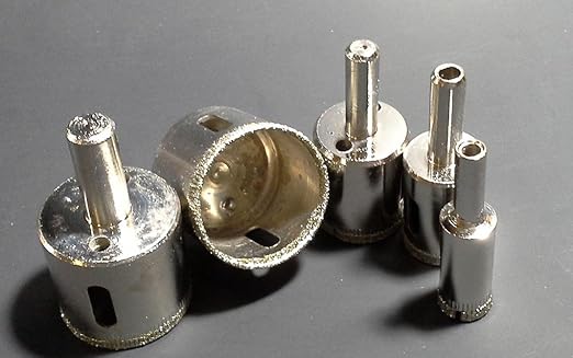

An improvement on that idear - for $5, you can get a 1-5/8" diamond hole saw and sink a kerf around the conduit, makes the chipping that much easier for 1" and less conduit !

I have seen these before but never thought it would be any good. Have you used them with any success?

I haven't tried it, but why not some "pipe insulation" around the raceway at the wall penetration before concrete is put in? This would (hopefully) be easy to dig out to allow space for a fitting on the raceway. Rigid foam type should hold up well enough. Of course OP is likely beyond the point of using this method on this particular job.
