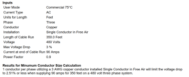

When determining current carrying capacity of MI which column is used(75 or 90) and whihc table? Thanks.
One KO complies with 300.20Does it matter if it's 3 conduits under one jacket?
How do you know what the load is for the calculation?The cables above are run from a 90A breaker to a 90A breaker 350'. According to my VD calculator #6's won't work to keep VD under 3%. Would need #3's. 480v switchboard.
Does that make sense?
If the load is more than 20 amps I would be surprised.I don't know the actual calculated load but it could not be over the 90A, correct?
My calculator said #2 for 3%VD at 90 amps and 350'.Is my post #7 correct?
That's correct #2. My fat fingers punched in the wrong number on my phone app.
