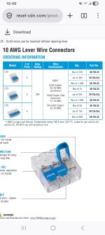

More availability on CCA splices
letgomywago
Washington state and Oregon coast
residential electrician
So since the issue of CCA needing listing differences vs cu cu listed wirenuts I noticed this on ideals latest cut sheet for lever lock style connectors. There's no a legitimate option other than CCA wire branded wire nuts. It looks like ideal is interested in getting some connectors CCA listed and identified.Screenshot_20260117_224919_Firefox.jpg
