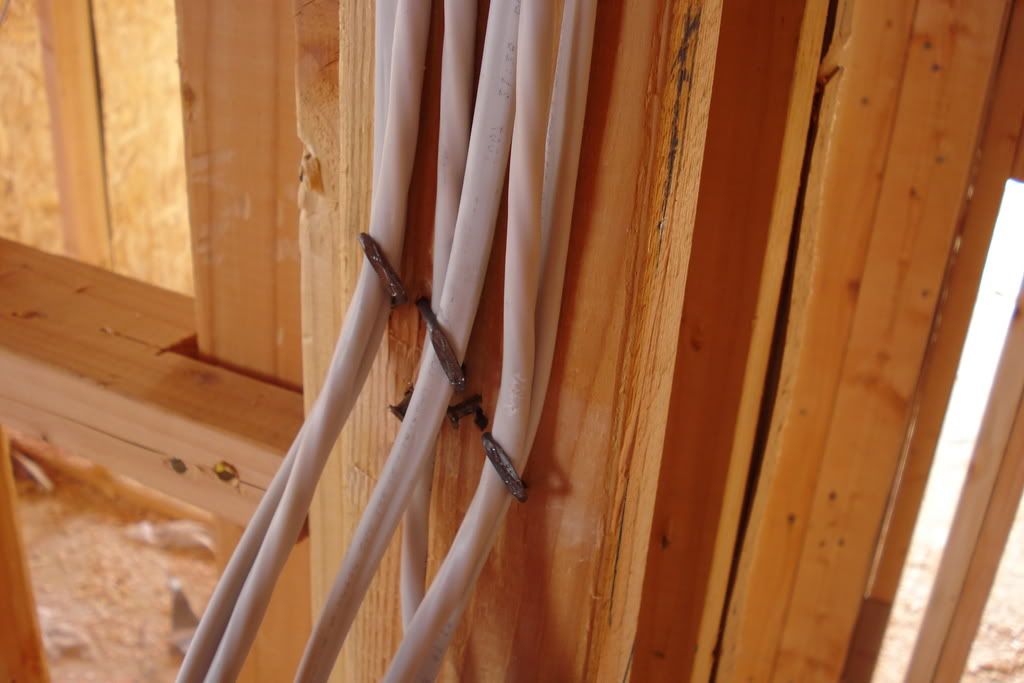

Kinda hard to tell but that's 3 runs of cable down the side of a 2x4. Again, 1.25" of clearance doesn't seem to be taken seriously. Typical throughout this house and all the rest in the development.

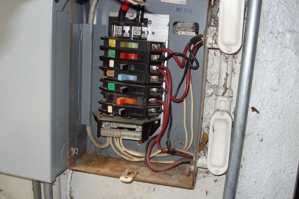

The Cancer of California aka Zinsco. This was exactly like this when I opened it - deadfront missing.
I have noticed in most of the pictures that have been posted on here, people use one piece steel staples, everyone around here uses the insulated style that have two small nails and a plastic strap, is there some advantage to the all steel? seems to me that the plastic ones would be less likely to damage wire.
If you know how to staple a staple, there is little risk of damage. Peter, are there no stackers used in these houses?

I guess Im wanting to know the advantage of the one piece staple, are they less expensive, easier to use, only thing avaliable in the area? Im not knocking them, just never see them in this area and curious....
They're cheaper. And as mentioned before, if you know how to staple correctly, you don't damage the cable.
the biggest problem (other than price) with those little plastic/nail staples is when you put them in your pouch you end up spending more time fishing for the little nails to put them back into the plastic piece because they always fall out.
Not a problem with the one piece staples.

one thing it kinda bother me one bit why they leave the wire on the flat 2by4's and one thing if some dolts have oversized drywall screw it can hit the wires there

Metal staples tend to cause false GF device tripping.
Yeah, right. I not only disagree, but I feel pretty good about saying that you're just plain wrong.
Overdriven staples of any sort can cause this, not metal staples.

I almost never see the copper exposed through the jacket, but the actual conductor insulation is split and contacting the ground inside the jacket. It's rare that I get to actually salvage the offending piece, but when I do, this is what I find. Typically I can just measure that a piece is bad, but it's abandoned behind the building's finishes. 3-wire cable is a bigger offender than 2-wire cable. On very rare occasions I have found the jacket split too, and I have to doubt the qualifications of the person who installed the staple. Some guys whack in staples like they're chopping cord wood. Insulated staples would be a good idea for installations being done by the less skilled.
