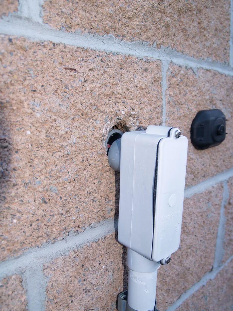

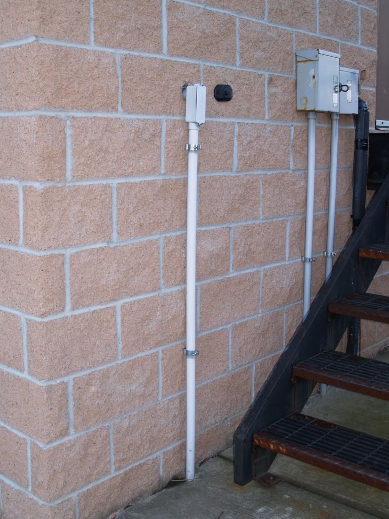

Here we see the PVC that is affected by the settling around the building. You can see the PVC has moved the distance of the width of the strap.
You can see it by the color of the PVC
The glue in the LB held on the vertical, but not the horizontal fitting.

I see disconnects in your pics, but where is all this equipment?
prolly fed from the building to equipment outta site of the pic... I like the straps the guy put in the joint

The installation is several years old.
The one installation where it looks as though there was no glue applied to the PVC, that could occur within one season after the install as the earth settles from the construction process.
