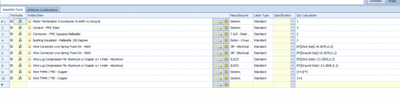

A Alwayslearningelec Senior Member Location NJ Occupation Estimator Dec 14, 2023 #1 This is an assembly from my estimating program for a 3 phase motor connection. Would it be common to need to use a lug above a certain size wire?

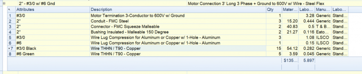

A Alwayslearningelec Senior Member Location NJ Occupation Estimator Dec 14, 2023 #2 Here's one with the hours. I'm not sure I agree with the 1st line labor whihc is just over 3 hours. If you have labor for lugs or wire nuts why is that needed? Almost 6 hours for this termination seems like a lot of time.
