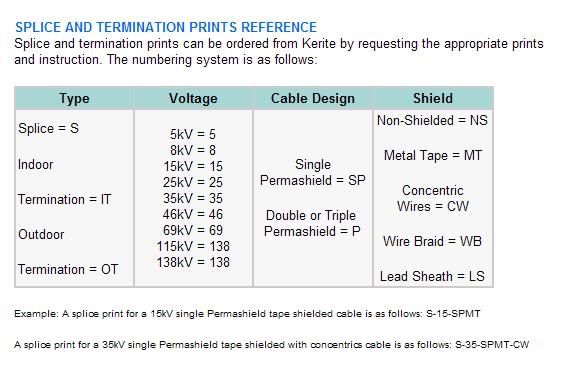

quogueelectric, cable manufacturers usually do not give you splicing and termination instructions. Kerite is the only one I have found that does and they are only hand taping instruction's. The suppliers of the particular termination or splice you are using are normaly what is used.
mdshunk, dead break and load break elbows are not used in motor terms. It is not practical. 3m, Elastimold and Raychem do however make some pretty cool term kits. Actual lead wiping of cable with the solder pots and all is a rare occurrence these days. They make lead to solid dielectric kits now so you can take off with EPR or XLP. The old lead cable will last forever as long as it is undisturbed.
Nick said:
...cable manufacturers usually do not give you splicing and termination instructions. Kerite is the only one I have found that does and they are only hand taping instruction's.
Thanks for that tidbit.
Here you go, if you want to order the tape type termination print(s):
