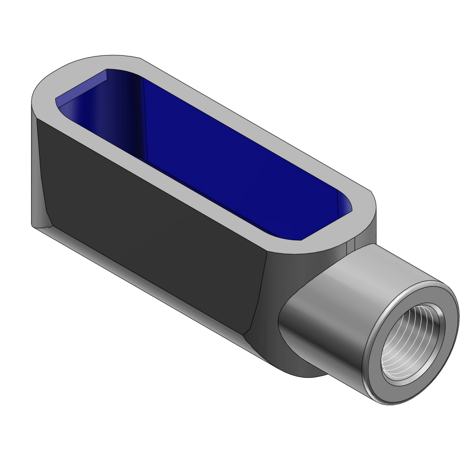

1). what is an example of a conduit body with only one conduit entry?
2). why didn't the last part of the exception just say "if the trade size of the conduit body is not larger than the trade size of the conduit" instead of saying the largest trade size of the conduit?
Why did they add "largest"?

1) A conduit body for a dead end circuit (e.g. possibly to support a later extension of the circuit), such as a 'C'
with one end plugged.

I just couldn't think of a conduit body with only one conduit entry. I guess if you plug the other openings, any of them could be.:cool:
2). why didn't the last part of the exception just say "if the trade size of the conduit body is not larger than the trade size of the conduit" instead of saying the largest trade size of the conduit? [/I]Why did they add "largest"?
You might have more than one size conduit entering a conduit body.
A "E" conduit body.

If you are using an over sized LB with reducing bushings and the LB has a volume of over 100 cubic inches, you would have to provide independent support for the LB.
If one of the two conduits (largest) is the same trade size as the LB, the independent support would not be required.
I think that when you get to LBs in 2 1/2 or 3" size you are often over 100 in?.
One entry conduit bodies (type E) are typically used to house air temperature sensors for larger buildings. From Don's link:

The exception says "conduit body of any size" I don't see where the 100 in.? applies.
Also, I didn't even consider a conduit body larger than the conduit using reducer bushings. Now it makes sense.

Yes, the 100 in? only applies where the conduit body is of a larger trade size than the largest conduit connected to the conduit body.
