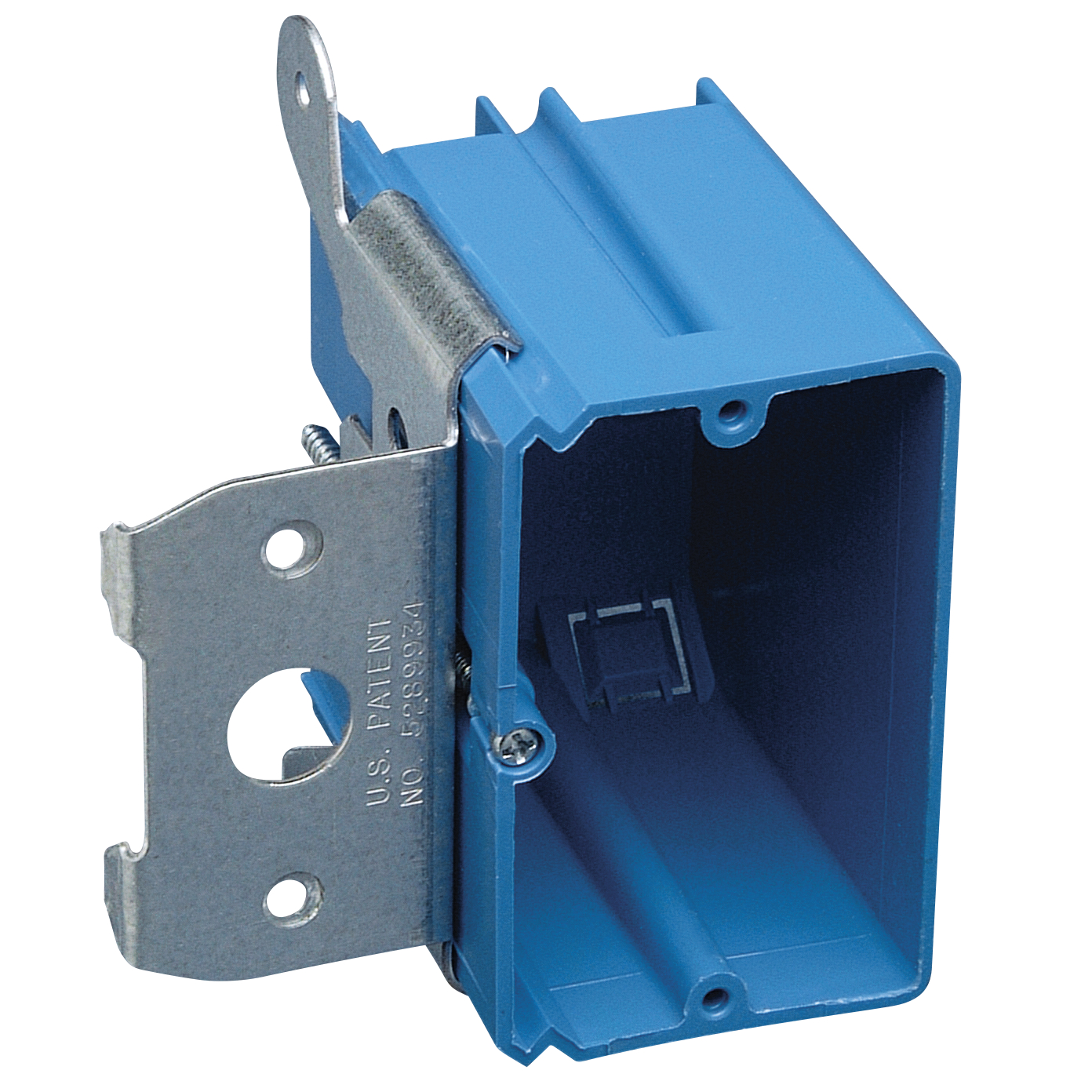

b121adj_cl1
I agree with using these next time. Hard lesson learned there. :)
b121adj_cl1
Yeah, you think so, until you come back to trim and find that the tile guy made his cuts so tight that they overlap the edge of your nice adjustable box. Not as bad as sticking out too far though.
