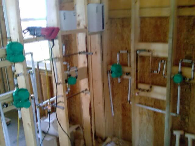

Just for kicks, here is the master shower...
Roughly 25 gallons per minute with two 3" drain lines for dispensation. :cool:
