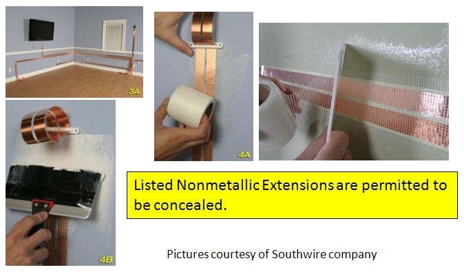

A) one or more extensions shall be permitted to run in any direction from an existing outlet, BUT NOT ON THE FLOOR OR WITHIN 2" inches from the floor
Is nec really saying plastic non metallic receptacle extensions cannot be used on tbe ground floor? I seen this done all my life.
Or is this meaning something else or for another application?
