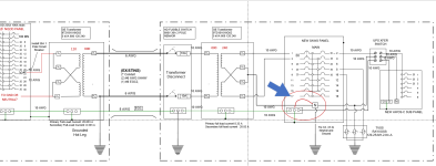

Does the Neutral have to be tied to the EGC at the Blue Arrow?
Did I make a mistake in my wiring?
Everything is working fine, but I'm told that the Neutral Bar in the Panel must be tied to the Ground Bus Bar in the Panel because that's where the separately derived system actually starts.
Since this is the origination point of the separately derived system, did I make a mistake?
Thank you in advance
The neutral must be tied to ground at one and only one location.
The blue arrow is a good location, and is also above the note telling you to do this.
Your other option is to bond neutral to ground in the transformer.

FYI, the green conductor between the transformer and the main disconnect is a system bonding jumper sized per 250.102, not an EGC per 250.122. This is also dictated in 250.30
No. The SBJ can connected in the panel or in the transformer. I prefer installing it in the transformer but it can go in either location just not both. I've never installed the SBJ anywhere but the transformer.
The Green conductor between the transformer and the main disconnect is not a system bonding jumper, it should be a supply side bonding jumper.
It may go in both locations as long as there is no objectionable current produced on equipment. Installing the SBJ in two places essentially places the neutral conductor and grounding conductor in parallel with each other as current seeks its way back to the source. :)
Both or either? The code section in post 3 says "single point". Both would not be a single point.
For the sake of linear thought and simplicity, I would say "either", and you are correct in the fact that both would not be a single point. But in actuality, it can both. I like to picture an overhead service to a house. The neutral is grounded to ground at the utility pole at the transformer location and then bonded at the first means of disconnect. The two connections are allowed because there is no EGC providing a parallel path in the aerial drop. I think that same logic can be applied to underground installs as well.
So do I need to tie the neutral to the ground bar? thanks
