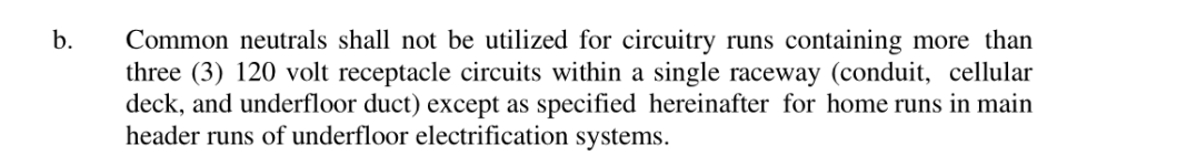

Neutrals
There is no MWBC that would have more than 3 phases sharing a single neutral. They're just wasting ink the way they worded it.
I think they are alluding to possible derating of conductor?
3 phases + neutral of a MWBC means no derating (under normal circumstances).
6 phases + 2 neutrals of a MWBC means derating.
1 phase + one neutral of a circuit with 3 Phases + neutral of a MWBC is 5 conductors and need derating.
Really wierd language though. Seems like they could have been more clear if they are trying to limit the number of CCCs in a conduit or limit the number of phases per MWBC.
True but the limit to 3 circuits is what I believe is unnecessary
There is no compliant way to have 4 phases and 1 neutral of a multi wire branch circuit. A, B, C, + neutral is 3 phases plus neutral. If you tried to make it 4 phases, for example, you would end up with a neutral carrying A phase twice and that would no longer be a compliant MWBC.
Without more context I'd assume that they are just restating what any electrician who deals with 208/120 ought to know. The last bit about underfloor electrification systems sounds weird though.
