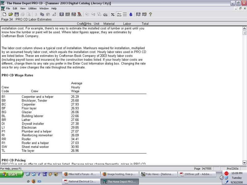

I am bidding a job in North Jersey and I am still new to residential. The house is a partial teardown and a new large addition. I need to move the service and upgrade to 200amp. I have 140 holes and 70 recessed lights.Also there are 7 smokes/co figure 100 each. In my estimate I am thinking 50 per hole(ceiling/sconceboxes/switches/receptacle) all decora, 70 per recessed light and 1650 for qo service panel. What do you guys think and is there an estimating software that will teach me the numbers in my region..North Jersy...or is a question of trial and error. I know we are all in business to make money but I also like to do the right thing....What do you guys think. And dont forget if there is software for a one to two man shop that is worthwhile let me know, or give me the link and I'll do my own homework.

IMO for Northern NJ, $70/ recessed light is far too low. You should be in the $100+ range. And $1650 is also too low for a 200 amp service. Don't forget to add in dollars for disconnecting existing stuff in the rip out portion of the house. And some of that stuff may require re-wiring.

How are you arriving at these prices?
More importantly - what is the total manhours?
I charge about:
- smokes...$156, combo units..$211
- $70/recept ($75 for decora)
- $80/switch ($84 for decora)
- a 20A decora GFCI is about $95.
Home runs are a seperate cost at averaging about $2.25 ft, CB's cost ~ but in this instance, that number will be incorpoarted into the new service price - excluding any new home runs.
Fixtures are another animal - who is supplying the fixtures? Where is the cut sheet coming from? Not all fixtures are an easy install....basic ceiling fixtures rough cost $80; sconces $90 ~ this figure does NOT include the fixture hanging, nor the fixture itself - essentially, a roughed in box w/a pigtail for the other trades to gain some light by.
Speaking of temp. light - are you factoring in any time for temp light/power?
Recessed cans start at $165 - includes the fixture, lamp and a colifax(step baffle) trim...shower trims are extra.
200A OH service swap in SE starts at $2800
No offense, but I think your prices are way low.
Based on the numbers given, I'd would be in the 30k neighborhood w/200+/- manhours.

For every item in new work, create an "assembly".
An assembly is nothing more than a list of the parts needed to complete the average assembly - including:
- the cost of the goods
- your mark-up on the goods
- tax on the goods
- time to install the goods (manhours)
Here is a picture to illustrate this (is that redundant :) ):
I have also included the manhours for "rough" and "finish" on any given assembly.
Creating the assemblies is the easy part - the difficult parts are:
- finding accurate prices for the goods[that can be updated daily at low cost]
- finding accurate man-hours for installing the goods
- determining a realistic rate to charge per hour.

finster, if you really want to learn, it's simple....get a copy of a book, celtic will give you the proper name, called something like the Craftsman National Estimator...
utilize their labor hours, and get your real material costs...it will take time, but do a complete takeoff of the project...all material, labor, etc...add in your overhead and profit and see where you are...
(Home Depot Worksite CD ~ HD WS CD)
FREE...IF you can find it (yes, that is a big "if" ~ LOL)
HD has this online version (Quote Estimator)...I haven't tried it.
The National Electrical Estimator (TNE) is about $40 at amazon.
The major difference (other than the bank breaking 40 bucks) is the updating...with the HD WS CD I can update pricing as often as HD does (daily)...TNE is updated monthly(?) ~ and charges a fee.

Does that program do electrical as well, It looked more towards building.
It does it all :D
Look at the trades listed here:
I could price out my own deck job and shop MY price to contractors :wink:
BTW, you can adjust the wage rates however you see fit.
Yes. Works pretty good, use it all the time. But the way they list an item is non-Navy. Usually you would expect the noun first like...Box, electrical, non-mettalic, blue. But they might use the verb first like...blue box (not an actual listing, just an example).
And, the technical descriptions are pretty skimpy.
