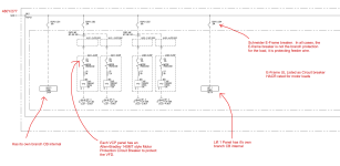

Wanted to get the experts opinion on this single line...
Planning to use Schneider NF Panelboard with 30A E-Frame breakers. From my understanding, in this design, the E-Frame breakers are not the branch circuit breaker because each downstream panel has it's own circuit breaker. For some reason I'm getting some hesitation from our material vendor that these E-Frame breakers are not rated for this. Something about motor loads, but these are HACR breakers made for motor loads. Plus most all loads are on the other side of a VFD.
Your drawing shows the E-frame breakers as the branch circuit protective device.

Jim...thanks for the reply. I guess I've always heard the BCPD was the last protector before the load. Do you see an issue with the design or using E-frame breakers in general for this application?
No. This is what they are designed to do.
Your are correct the last OCPD defines the branch circuit. The branch circuit ends at the outlet, which is usually considered as the lugs for Listed equipment such as packaged controllers.
I come from the panel shop world where we built large multidoor MCPs that housed a Main CB (Molded Case CB), Power distribution block, Motor Protection CBs (140MT), VFDs. Inside that UL listed panel, we would have considered the Main Breaker and the wire down to the Power Dist Block feeder wire and the wire from the dist block to the MPCBs tap wires, the MPCB and downstream we considered the branch.

That was your choice to use those terms.
The NEC does not apply to the internal wiring of Listed equipment. This is why an NEC branch circuit does not extended past that equipment's terminals.

Just to comment on this. Not sure what they are talking about. There is no such thing as a breaker being only rated for a branch circuit or a feeder. Sure you could get into series ratings or coordination and run into a certain circuit breaker not having the characteristics needed.

Thanks for the reply. I think they want us to use a iLine panel with PowerPact style Molded Case breakers. Its literally 3 times the cost for the same configuration. I can't determine what the Powerpact gives me over these E-Frame breakers.1743735261940.png
The choice between I-Line and NF is usually made based on voltages (NF is limited to 277V to ground), breaker sizing (I-Line can be 1200A), and accessories.

Any the breakers can be used for feeder or branch circuit. Only distinction between feeder and branch circuit is how it is used. If final OCPD before the load it is the branch circuit device.
Could possibly argue that the final device before a listed appliance or other assembly is the branch circuit device even if that appliance/assembly has additional overcurrent devices within it since NEC doesn't really address what is within that listed item.

Yeah I think the point I was trying to make, and maybe it doesn't matter, is that our intention is not to use the E-Frame breaker as the only SC protection for like a motor starter. Even if we were feeding power to motor starters, we would still have a 140MT din rail mounted MPCB in front of the contactor acting as the short circuit protection.
