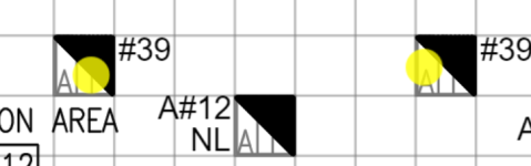

A Alwayslearningelec Senior Member Location NJ Occupation Estimator Apr 11, 2025 #1 Any reason why a night light fixture(not an EM) would be circuited to a different panel from normal fixures?
L letgomywago Senior Member Location Washington state and Oregon coast Occupation residential electrician Apr 11, 2025 #2 What panel are the general outlets on?
infinity Moderator Staff member Location New Jersey Occupation Journeyman Electrician Apr 11, 2025 #3 Alwayslearningelec said: Any reason why a night light fixture(not an EM) would be circuited to a different panel from normal fixures? Click to expand... If the normal panel were to fail the lights would stay on. Designers still use night lights? I thought that the energy code killed that design
