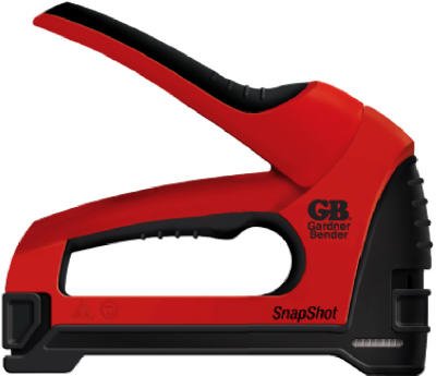

I have this one and really like it.
Before that, I don't remember the brand, but I had one that was made of metal and plated. It sucked. About every 6th shot it would jam and it would take several minutes to pry out the jammed staple.
I have made 1000s of shots with the GB and only have had a couple jams which only took a second or two to clear. They cost about 30 bucks.

I have both of the manual staplers available, the PowerFast and the GB.
The PowerFast was OK, but I had quite a few misfires or jams. For a while it was a challenge finding staples for it, but Home Depot now has them in their system.
With my staple supply uncertain, I got the GB. It works much better.
That is what we own also. Lowes
Why not just use a hammer? Well, it seems I'm always either stapling overhead (crawl space) or in tight places where there's no room to swing a hammer (attics, near the eaves).
Don't you wish there was a way to 'cock' the GB so you could fire it with a trigger pull, instead of having to squeeze the lever all the way down? There are some positions where your hand is at such an angle it's REALLY hard to do that. It would be nice if you could hold the stapler comfortably, squeeze the lever, then put it into place and fire it.
