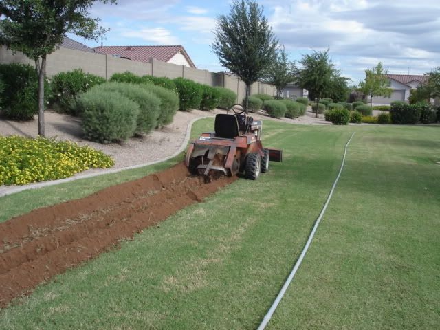

Heh heh...I have installed miles of PVC and never even HEARD of an expansion fitting until I started reading message boards.
I've still never seen one.
I probably need one here too huh? 500' of 1"?
