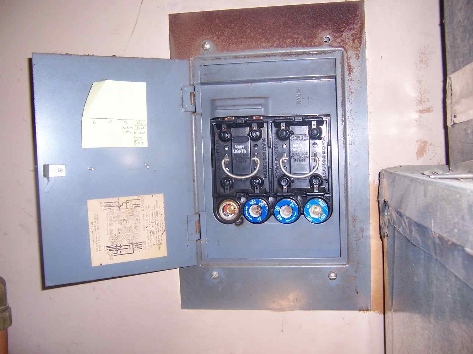

Ya, I think you might be. Look at the bus diagram on the cover, the next time you are there, and you'll see, I expect, that there are two 30 A max fuses on one 60 A Main.
Gotcha... I found a pic of a virtually identical box, FWIW:
attachment.php
At a glance, I had assumed this to be a split bus... There was no diagram on the box in question, so I'll have to remove the wall and pop it open. Either way, there's only 30A (@ 240v = 7.2kva -- so I'm clear here) available to house today as it feeds from here to a 30A rated FPE fuse box via 10/3.
