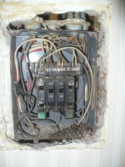

Ca. 1960's high rise so I know it is difficult to compare with what we do today. However, am I correct that the presence of metal lath within the "space" of the panel (behind the cover) would have been considered a defect then?
In addition, the cover does not rest squarely with the panel - sits flush with the plaster and is attached with very long screws. When the cover was removed, an air current was detected - I'm guessing this is the cause of the dirt in the panel. Didn't the cover have to mate squarely with the panel?
http://i15.photobucket.com/albums/a352/TonyPE/P1160381.jpg
Here's the current requirement. Not sure if it was applicable in 1960.
312.3 Position in Wall.
In walls of concrete, tile, or other noncombustible material, cabinets shall be installed so that the front edge of the cabinet is not set back of the finished surface more than 6 mm (? in.). In walls constructed of wood or other combustible material, cabinets shall be flush with the finished surface or project therefrom.

From the 1962 NEC:
372-3. Position in Wall. In walls of concrete, tile or other noncombustible material, cabinets shall be so installed that the front edge of the cabinet will not be set back of the finished surface more than ? inch. In walls constructed of wood or other combustible material, cabinets shall be flush with the finished surface or project therefrom.
Oh, wait, you just said that. The language goes back to at least 1937
I see this alot in older high rise buildings built back in the 1960's. But here they didn't have a building code and permits, and inspections, and contractor license until around 1967. So all old junk that wouldn't meet the Nec then, is grandfathered as is. Mess with it and you have to fix it though. That is when all the fun part starts.
I have seen many of those Square D panels with an extension ring added to make it flush with thicker plaster or wall board, but they would be hard to find now.
Also keep in mind that older BX can't be used as a grounding path unless it has the bare shorting wire in it.
It also appears that this is a 3-wire feed H,H,N and there is no bonding of the neutral bar (empty hole to the right of center) unless there is a grounding conductor in the main feeder?

so with this one could say that just changing the type of receptacle should not require us to add a ground to non-grounded NM, and 406(D) was written for nothing? as the wiring method was legal at the time it was installed.
Edited to add: I have to agree that since the 3-wire receptacle was legal before the replacement and replacing it with a like receptacle would most likely be legal and protected by the grandfather clause, but we are talking about non-grounding receptacles being replaced with grounding receptacles, where the wiring method doesn't support the grounding method required by the code at the time of the replacement.
Again, the type of outlet on the end of the wiring method has nothing to do with whether the method is a grounding means.
Grounding type receptacles were required in specific locations, historically, prior to the 1959 NEC. When those certain grounding type receptacles were supplied by a non bonding strip BX wiring method, it sounds like you would allow the grounding type receptacle to be replaced with a grounding type receptacle, i.e., allow the BX to continue to be used, as it was when it was installed, as a grounding means.
However, it also sounds like you're also saying that the old BX can't be a grounding means, period.
The last sentence of Annex H 80.9(C) is for "additions". Replacing a existing receptacle is not an addition in my opinion.
The first sentence of Annex H 80.9(C) is more on target, including "alterations, or repairs" and permitting the AHJ to establish what parts of the current NEC an existing installation must comply with. Continuing to use BX as a grounding means, in existing pre 1959 installations, doesn't "present an imminent danger to occupants" (Annex H 80.9(B)).
