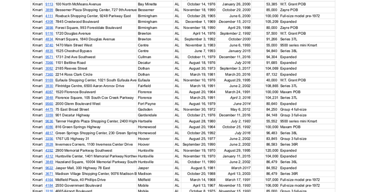

They must have, this store was pretty old even back then. The company I worked for at that time did a lot of their remodels. This was one in Huntsville, Alabama, if I remember correctly. They were taking the snack bars out of the stores at that time.Rather scary thought that the breaker did not trip. Did K Mart (then the parent co was SS Kresge(sp?)) spec FPE gear? The local K Mart that opened in 1973, & closed Jan 2020 had FPE gear, which is not common around here either. Most common place to see FPE breakers was in Zinsco/Sylvania switchboards & panelboards.
