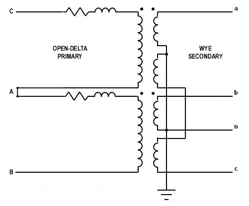

I am upgrading building service from 240/1/60, 400A to 480/3/60, 600A for my machine building business. The local utility committed to the installation, I put in the conduit, transformer base, etc. One month later, the utility wants to change to an open wye delta 480 system instead of the standard method to save money. I am not a utility engineer, so I have a feeling that I'm going to get the shaft somehow. They are pressuring me to keep the current service and add the open wye service through a second meter. Can someone give me some guidance whether I'm asking for trouble with PLC's and other control devices or trouble shooting ground faults or something if I accept their changes? I can't find a lot of information about open wye delta after the utility's connection.
