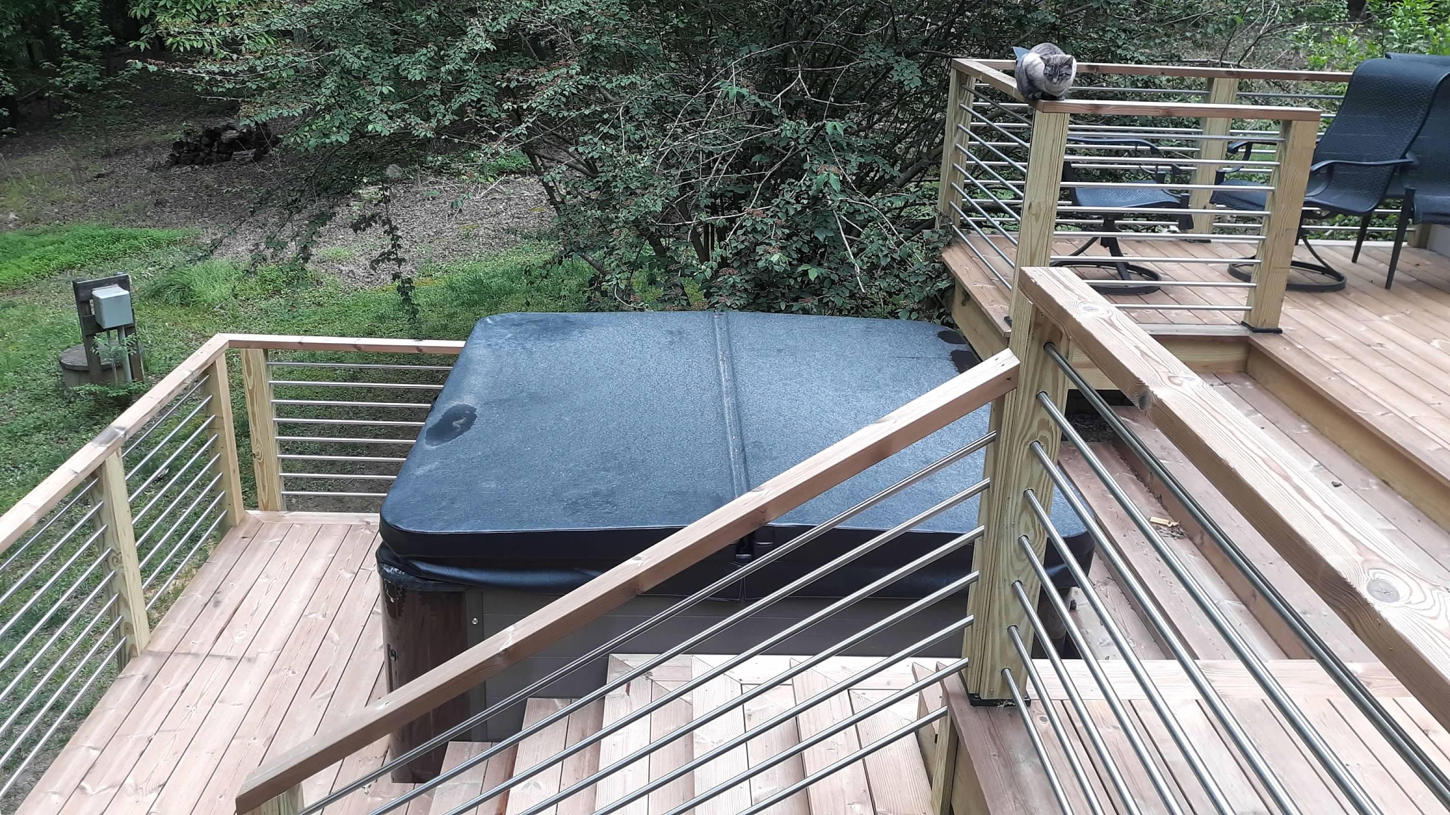

Situation is an outdoor hot tub on a deck with the deck metal hand rials within reach thus not in compliance with 680.42(B)(4)...
Is the solution some means of bonding the railing (if so to what),or replacing it with a non-conducive railing, or other,

That's what I picture from the description given. The way 680 is worded, the perimeter bonding is not needed IF the 4 conditions are met. Since #4 is not met, would you need a perimeter bond under the deck ? ? What would you bond the railings to

I do believe per code you need the perimeter bonding in the dirt under the deck. The hand rails would have to bonding and connected to the perimeter surface bonding and the motor along with any other metal parts within 5' of the tub.

Looks like the deck with the tub is several feet above grade. A perimeter bond wouldn't do anything.

Yeah, that is what one thinks but that is the wording in the code. It doesn't have an exception for tubs on a deck. I actually do believe that the equipotential bonding or perimeter bond could potentially help with stray voltage. Wooden decks do conduct especially if they are wet.
I did this a few years back. They didn't have the ground clamps I wanted so I could go straight up thru them all so I did this monstrosity. Not so proud of it but they needed it done. We also had to bond the gutter which is not visible

1st question, why are you being required to bond metal that is isolated from ground? if you have a metal framed sliding door within 5 feet would you bond that too?
2nd why use clamps that are not direct burial rated, when exposed to the elements?

They are DB rated and the rails are somewhat connected to the 4x4 's that go to earth. There are clamps that are rated for db that are not Bronze
Seems like a case for some design that has a fancy metal cross piece that looks like it is decorative, but bonds them together and then that one piece is bonded at the bottom.

How would you bond wood?
What about when someone shoves a tub up in the corner of a patio, with two brick walls, are you supposed to bond the brick?
What about a pergola with cedar post, you supposed to bond that?
Can’t remember the specific article, but I believe it is in section two, mentioned something about bonding not required when a tub was made of no conductive material.
680.42 B 4 is getting to me right now. The tub sets on a concrete which is considered to be grounded. 28” why? I could stand on the ground and bend over the tub and probably immerse my head and shoulders in the water, or the other way.
I can understand, if having any type of metal within 30”. At that point I suppose you bond each individual piece of metal, to the internal ground point on tub, back to main with one continuous run of #8

So 680.26 equipotential bonding
(A) performance. We can agree on
(1) conductive pools
Manufactured tub is not
(2) perimeter surfaces
First sentence says shall include unpaved surfaces and other types of paving.
Last sentence says for no conductive pool shells bonding at four points shall not be required.
At this point, I don’t think anything needs to be done for a manufactured listed hot tub.
(3) metallic components
Don’t think we have that issue
(4) underwater lighting
Most likely not
(5) metal fittings
Maybe if built in to the ground. But we have a manufactured listed unit. Mess with it or modify it and bye bye listing.
(6) electrical equipment - I believe everything is bonded at the factory, which is satisfied via EGC
(7) Fixed metal parts - this might be the real concern and we are allowed a few exceptions.
Am I misunderstanding?
