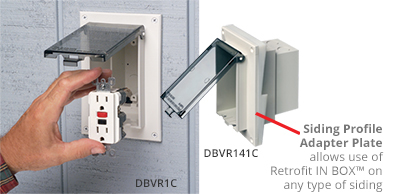

Since this is a damp location an in-use style cover is not required. You would need a" shall have an enclosure for the receptacle that is
weatherproof when the receptacle is covered (attachment
plug cap not inserted and receptacle covers closed)." This might give you more options maybe one of these:
That would work if they were not designed so that the covers stick straight out when in-use.
The covers are about an inch and a half so they actually take up more room than a slim in-use cover ( 1"). When closed they are good.
He stated that the cord has a "the fridge has one of those massive gfci ends on it" which is probably just as big as the cover in the photo. Otherwise you would need a flip cover that opens more than 90?.
