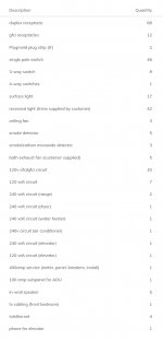

Last house I did had 80 something receptacles, 30 something SP switches, (14) 3-way switches, 109 recessed lights, 14-16 sconce lights, 5 chandeliers, 6 ceiling fans, 6 flood lights, one 200A main panel, one 200A subpanel, one generator interlock, one generator inlet, two ground rods

This was 2 levels with finished basement ADU apartment and 2-car garage on basement level, elevator, 400 amp service with 100a subpanel in ADU and 200a subpanel in 2nd floor hallway.
Total finished square footage was about 3,200Screenshot_20230624_133659_Invoice2go.jpg
