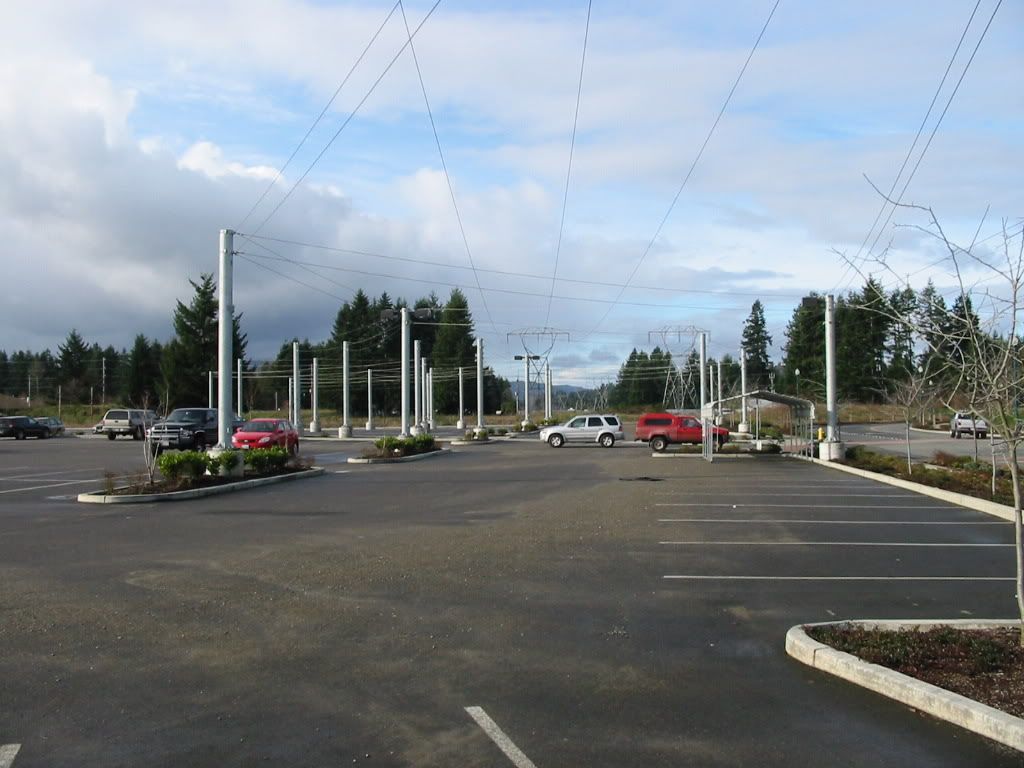

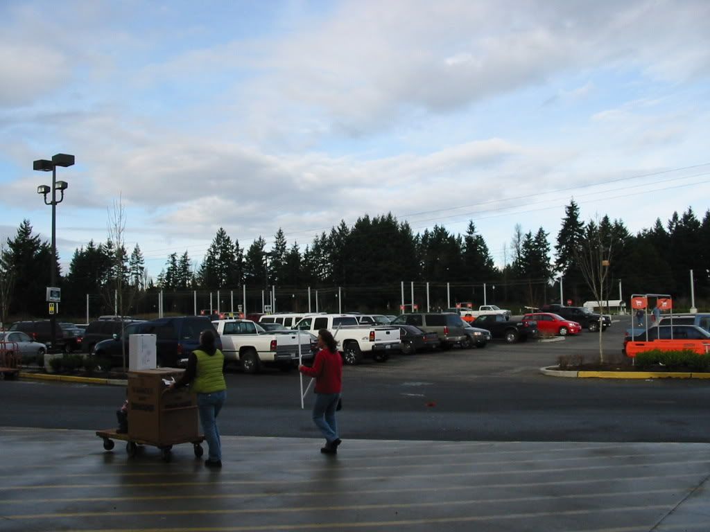

In Tumwater Washington State, a Home Depot has part of its parking lot under high voltage (perhaps 300 KV) lines. There is a overhead "grounding" grid under the lines. Charlie (moderator) said its to reduce the induced voltage in a shopping cart under
the lines. Take a look:
http://i42.photobucket.com/albums/e334/TomBakerPhotos/GroundingGridfromStore.jpg
http://i42.photobucket.com/albums/e334/TomBakerPhotos/Luminaireoverheadground.jpg
http://i42.photobucket.com/albums/e334/TomBakerPhotos/CarsunderOHP.jpg
http://i42.photobucket.com/albums/e334/TomBakerPhotos/OHPandParkingLot.jpg

The overhead ground grid will also make sure that any "falling line" will have a return path for fault clearing.

Jim, thats what I thought orginally. I sent the pictures to Charlie E (Moderator-POCO engineer) and his coworkers had done an installation similar and it was to reduce induced voltage underneath.

The two things that strike me is that the arrangement of the wires doesn't look very uniform, I would expect something that more closely resemembled an actual grid. The supporting columns also look massively over-built.
Neat, though. I've never seen anything like that. Have heard stories about people getting nipped while doing ballast changes on poles under HV lines.

If you look at the picture, I only see one brave soul with a car under those lines!!

The utility here - most likely Bonneville Power - had an easement for the primary, the overhead ground was probably a condition of use.
