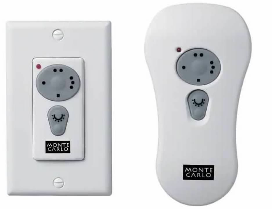

I am talking about this and they are sold this way

That type of wall control is just a wall mounted wireless remote. It may have a pair of black wires that connect like a switch but they don't provide an control over the fan other than a power on/off switch if the wall control has one.
If you were to try and use a standard wired dimmer/speed control it would not be comparable with a remote control.

Of course a standard speed control would not work with a remote. These are 2 electronic devices that work together and the wall switch changes the speed on the fan as well as turning it on and off. There are other devices as well.
