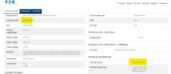

My question is: If I have a cutsheet showing 10 kAIC fully rated with a 35 kAIC breaker, but the equipment catalog states that this panelboard has interrupting ratings up to 200 kA symmetrical—can I say this panelboard is 35 kAIC fully rated instead of 10 kAIC?
Please see the picture below. It shows 10 kAIC fully rated with a PDD23F breaker (rated 35 kAIC). This is a PRL1X panelboard, and the Eaton catalog states, "Interrupting ratings up to 200 kA symmetrical." Can I consider this panelboard 35 kAIC fully rated?
I know the best practice is to request an updated cutsheet from the supplier showing 35 kAIC fully rated, but that takes time.
If this PRL1X panelboard is limited to 10 kAIC due to any component (other than the breaker), then I will need to have the cutsheet updated to reflect a 35 kAIC fully rated panel.
However, if all PRL1X panelboards are identical regardless of whether they are labeled 10 kAIC or 200 kAIC fully rated—or if the panelboard itself is rated for 200 kA symmetrical—then I can assume the rating is determined by the breaker. In that case, I would not need to request an updated cutsheet from the supplier, and I can confirm it is 35 kAIC fully rated, not 10 kAIC fully rated.
