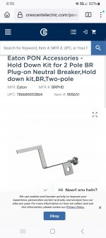

I don't know the answer to this but I installed a panel (for emergency circuits) and wanted to put in a 30A breaker to back feed the panel (for a generator). The panel had a 100 amp main breaker that was also a back feed. I bought the correct generator interlock. Problem I found was these "BR" circuit breakers the 100 amp 2 pole had a hole in to secure the breaker. The 30 amp did not. I found that BR 2 pole breakers from 50 or 60 (I forgot which one) and up have the hole the smaller breakers do not so maybe the 50-amp restriction on main breaker size posted above is correct.

The panel I had was a Bryant BR and of course the breakers were BR. The 100 amp main breaker had a hole in the breaker with a factory screw in the breaker. No problem their. I also bought the bryant breaker interlock for this panel and I intended to use a 2 pole 30 amp for that (4kw) gen. I also bought the Bryant "back feed breaker kit" that had a screw to go through the hole in the breaker just like the 100 amp main with a clip or something to screw into (forgot exactly how it went).
The problem was the 30 a 2 pole BR does not have a hole in it like the larger breakers do. I went to HD and looked at the BR breakers and it's either 50 or 60 amp and up have the hole for the screw the smaller breakers 20s 30s 40s do not

I was pointing out other manufacturers do have methods that will hold down most if not all breakers that are accepted by their panels. and this is a bit of a consequence of using that series.
Apparently Eaton does make another style hold down according to letgomywago.
