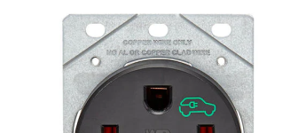

We wired a senior living development with about four planned home/townhome styles, about 24 got a EV pre wire upgrade (50A receptacle). Just over half of them got 6AL cable, the others for whatever reason got #6 copper (NM).
I forget how many but there were enough issues with the chargers and the receptacles our company was worried about a lawsuit, the senior center had sued the roofer and the plumber over other stuff.
All of the problems were with receptacles wired with aluminum cable, we sent the receptacles back to the manufacturer.
About a year later the manufacturer said the issue was with the aluminum terminations, their new heavy duty EV receptacles now have silently dropped support for aluminum cable.

All I know is since the new EV receps are marked "No AL or Copper Clad wire" we just stock large spools of (Copper) NM up to #6, and quit using 6AL SER all together, there are not any branch circuits in the new houses we do over 50 - 60 Amps. Feeders yes some SER AL but branch circuits now all went back to copper;
