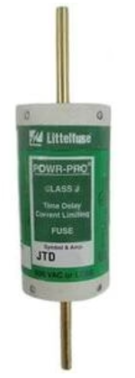

Question, in the attached picture, you will see that the parallel conductors have a fuse in each conductor, the other end terminates with both wires of the phase on one terminal, is this a good practice? I'm thinking that if a fuse would blow than the other conductor would have to carry the entire load? I have never seen parallel conductors installed in this manor before! What do you all think?

As I see it the conductors coming from the bottom are not parallel conductors even though there are 2 conductors together
If the fuses are part of listed equipment then the NEC parallel conductor rules do not apply.
I don't see the issue. Think of a large water heater where the loads are sub divided. It really isn't different. Those wires on the load side are not parallel conductors but they are using the tap rule.
My concern is if you blew 1 fuse on the same phase what then? Huge phase imbalance? Loss of 50% of the conductor? Weird voltage imbalances? It looks OEM but I'm just wondering why would OEM wire it that way? Seems odd.
i know it doesn't look that way but they terminate on the same point on the other end

But they are clearly electrically in parallel. Current flows from the breaker lug, splits to take one of 2 paths, goes through the fuses and then the wire, and joins back up at the next lug. It then goes through the load, splits because you have 3 phases, hits the next load lug, splits to take one of 2 paths, goes through the fuses, and then ends up on a breaker lug.
Is this a good practice? I don't know. It looks very much akin to 'cable limiters' or 'limiting lugs' that are intended to isolate parallel segments in the event of short circuit; but those are ordinary fuses that would blow on overload or short circuit. The breaker is an 800A breaker, the fuses are 150A fuses.... If you had a 400A overload on that setup I'd expect one fuse to blow and the second one to follow quickly.

I think I see what's going on now. The conductors are joined together again after the fuses. I missed that possibility. Those fuses are JT 150 which are 150 amp time delay fuses that are, as @ron stated, current limiting.
The install, as pictured and described by the OP, is not per the NEC.
It is likely not a UL508A control panel based on the apparent age of the modified back panel versus the conductors and fusing.
My guess is someone was not using the tap rule provisions of 240.21(B).

But the NEC (240.8) does not allow OCPD in parallel, unless they are a listed factory item.
